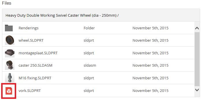

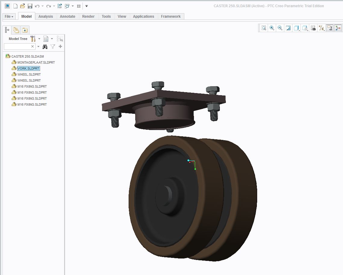

I've just got the trial version M020 to open some solidworks files that I downloaded from grabCAD...the ones I was sent by a solidworks representative did not work
I downloaded the following file pack and when i opened the assembly all files loaded in the model tree however vork.sldprt did not show.
Can you see what you get if you open the same assembly in your version?
GrabCAD - CAD library
It seems that the unite technology still has some way to go as the parts which have been imported have no features.....(please feel free to discuss all)

November 25, 2015
Nicholas,
in my CR3 M060 the assembly works the same way... I guess vork.sldprt is corrupted. See its "icon" in Grabcad window.
