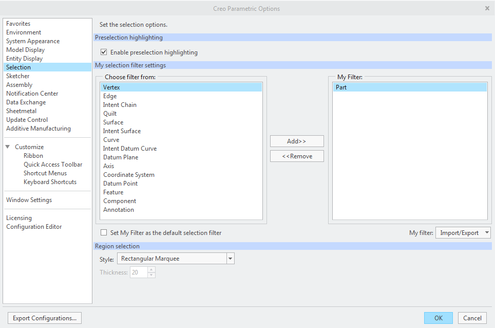

I also tried to define my own selection filter ( in file – options – selection ) and added only part to my filter. At first that seems to work fine, but it causes “problems” in other areas. For example activating a component in an assembly still leaves the selection filter on “my filter” ( part ) so I have to change the filter back to geometry to edit a part feature…

You can setup your own filter with whatever filter selections you want and then set that as the default:

Any news on the issue? I have the same complaints as you. For now I've defined my own filter as part, activation requires either I reset it or start diving into the model tree...

  5. Setting my own default filter and adding only part to selection does the trick. But when activating a component while filter is set to »my filter« (part), filter stays set to »my filter« and only component is available for selection. Is there a way to set that the filter while activating a component would change to component level filter. If not yet, are there any plans?
