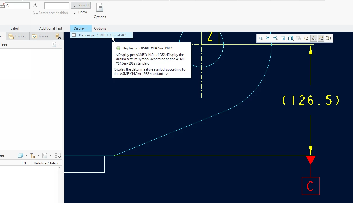

Rename the plane in the Datum tag what you need or create another plane and name it with the needed Datum Tag. This will work for planes and axis. The only one issue what I found is you can't manipulate the location of the axis datum tag anymore in the drawing environment. The planes you can still manipulate.

My issue is that now, when you rename and attempt to show the datum target, CREO uses the 1982 version of ASME Y14.5 for Datum targets (not the current with the perpindicular leader and filled triangle) and you also no longer can associate GTOL features with them.
This forces you to use the physical surface as the reference.
Perfect scenario: Weldment with multiple planar faces with the intention of them creating a datum plane with a combined planar tolerance. By selecting a face of a part rather than a plane, what happens when you revise the weldment and the part the datum is associated with is replaced/changes/moves? Well, your datum moves also. Had you been able to associate it to a plane, the individual faces are not critical, because what you intended to be your datum, stays your datum.
December 13, 2017
You can change from drawing mode or from Drawing Options
