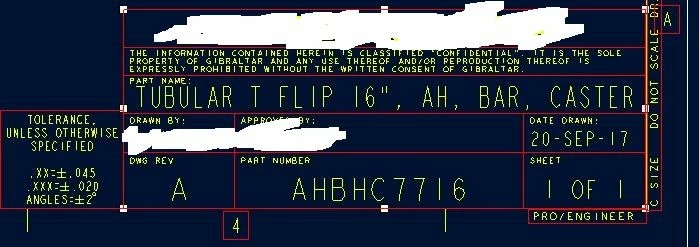

In the table tab, when selecting a table to delete, it picks the stuff around the table too so that when I press delete, it deletes more than just the table.
(I am coming from WF5.0 - so this may be something everyone else is used to or has adjusted to.)

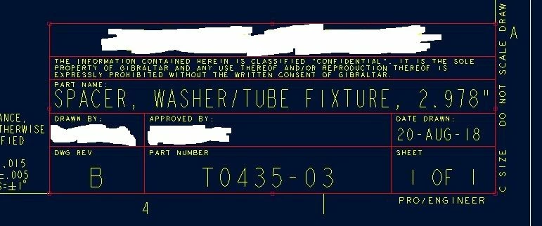

Here are the two scenarios: WF5 first and then 4.0. WF5 only picked the table and not all the annotations around it as 4.0 didn't pick only tables, but the annotation is touched as well.
With parameter, we find it easier just to delete the table and bring in the new table sometimes. Especially for specials where we do not "keep" the drawing except for a .dwg (yes AutoCAD viewer) before erasing.
August 20, 2018
Hmmm, not sure about that. I'm in Creo 3 and it doesn't select anything around the table. Everything comes from the format but the tables can be deleted without any of the other stuff being affected.
