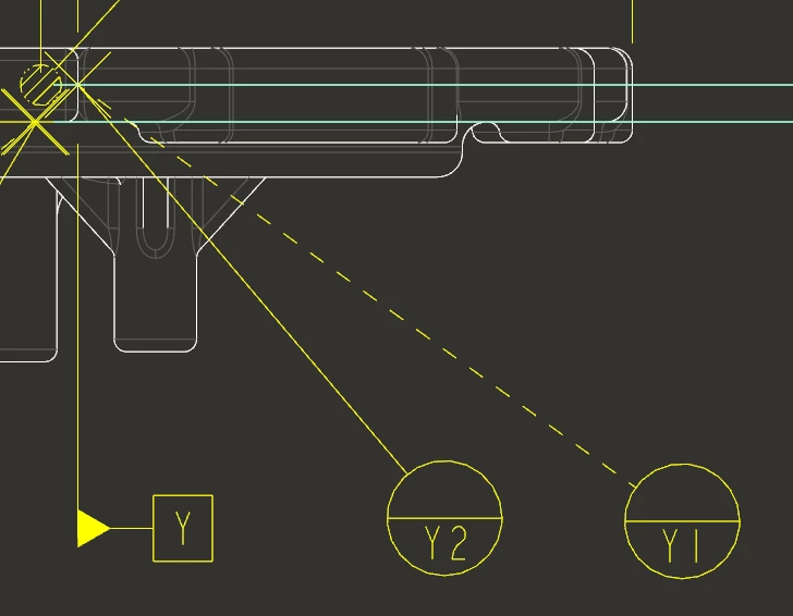

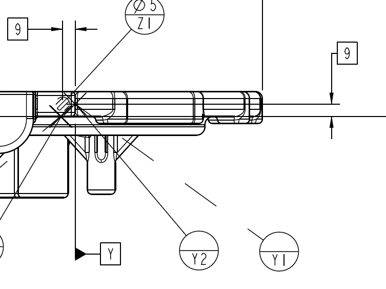

Hi Guys,
I am having trouble with the new Creo 4 datum target symbols. When I set the leader line type to far side (dashed) it displays the dash size I want in the drawing in creo, but when I export the drawing as a .pdf the dash line spacing is too big. Is there a way to edit this? What is causing the difference between drawing and .pdf?

It is possible to configure PDF output (and CAD worker publishing) to use a pen table, and a pen table can control the line spacing.  I would suggest starting there.  Take a look at this page:
http://support.ptc.com/help/creo/creo_pma/usascii/#page/fundamentals%2Ffundamentals%2Ffund_two_sub%2FTo_Change_Plotting_Pen_Attributes.html%23
August 9, 2018
I have not been able to resolve this. I am using M050. I tried the pen table route, but ran into the problem that the balloon and leader use the same pen so setting the pen to dashed results in the balloon note becoming dashed as well.
August 10, 2018
I wonder whether you can control the line spacing with the LINE_STYLE_LENGTH dtl option? I don't have Creo 4.0 to test but the steps in my post at https://community.ptc.com/t5/Detailing-MBD-MBE/PRODUCT-IDEA-quot-Allow-scaling-of-hidden-lines-in-drw-quot/m-p/550702#M26270 should apply
August 10, 2018
I tried both settings and the DASHFONT_S_S worked for me. I found that a value of "8" looked the best on the drawing that I was working with. I am just looking into if this setting may influence any other lines on the face of the drawing before we fully implement this as a permanent fix.
