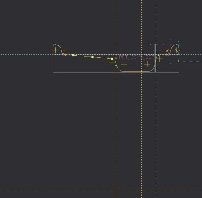

When using sketcher and sketching multiple holes of different sizes in earlier version you would get a designator that would let you see what hole you would snap to make the same size hole you wanted. Does anyone know how to turn this on in Creo 4??
Attached are 2 pictures of what i'm trying to covey, 1 picture from Creo 4 which shows just and equals sign but now way to differentiate between which hole would be snapped to.
The other picture shows how it is in Creo 3, easy to see which hole you are snapping to.

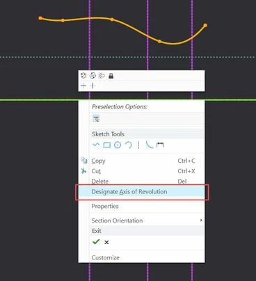

Best answer by mcestnik
Select the axis - right mouse button and press "Designate axis of revolution".2018-03-07_15-26-58.jpg

you must have the axis in your sketch, must be the 1st one. Can you share your section?
dimitrios1-VisitorAuthor
March 7, 2018

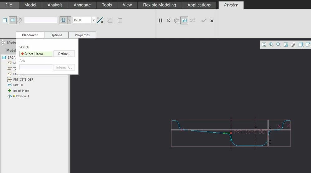

I want to revolve it around the horizontal axis ( the one which does not intercept the sketch) but when I select revolve feature , I get what you see in the second image wihtout being able to choose anything else exept a new sketch in a revolve tab
in thw sketch tabin thw sketch tabrevolve settingsrevolve settings

As per images, there is no possible axis for revolve hence getting stuck. If you will create an axis prior profile Sketch, it will allow revolve.

There are 2 ways to do it:
1.  Create a centerline in your sketch, and set it as the Axis of Revolution (highlight then Right mouse button).
2.  Have a datum axis created prior to your sketch, and use that.  Also, ALL entities must be on one side of the Axis.
