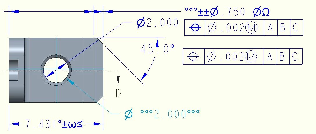

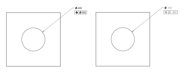

Creo 5.0.2 Diameter symbol stays bold
I'm having an issue where the diameter symbol is staying bold even after changing the font to legacy. Even if the dimension is created after the font change, it still is bold. The picture below shows the ASME (left) vs LEGACY (right) fonts. I can work around this by manually copying and pasting the diameter symbol from the GTOL frame to the dimension text, but this is slow and a pain on large drawings. Is anyone else experiencing this? Is there a way to report this bug to PTC for fixing

If the dimension is 'shown' from the model, then you need to set the detail option in the model.  Setting the option in the drawing only controls things created (stored) in the drawing.

Aaronm8714-AlexandriteAuthor
Feb 14, 2019 6:30 PM UTC
These are not show dimensions, but it looks like both are controlled through that dialog. Thanks!

Even I create a drawing dimension the font's change doesn't affect the diameter symbol or any other symbol added to a dimension. They stay bold no matter what font is set. Added frame control symbol inherits a bold font of the symbol while unattached doesn't.  Does anyone know how to fix it?

Are you positive you have symbol font set to legacy in both the model(s) and the drawing?

Path:
OPEN PART MODEL>FILE>PREPARE>MODEL PROPERTIES>DETAIL OPTIONS>CHANGE>SYMBOL_FONT>LEGACY
Refresh drawing.
Nov 11, 2022 11:09 AM UTC
Noteworthy, also check:
File -> Options -> Configuration Editor -> symbol_editor_use_symbol_font -> Yes
