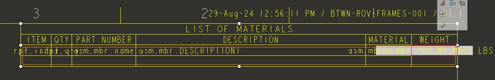

StephenW
Sep 7, 2024 2:50 PM UTC
Easiest way to get part parameters to an assembly drawing is via a repeat region table.
I use the system parameter for weight (pro_mp_mass) and a part paramter (description1) for the description in the example below
