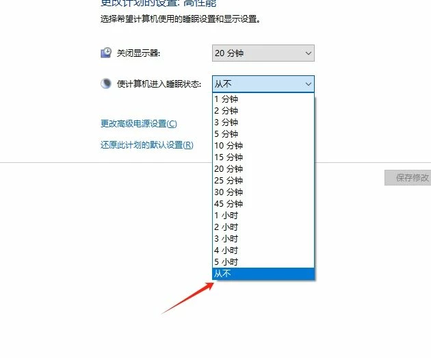

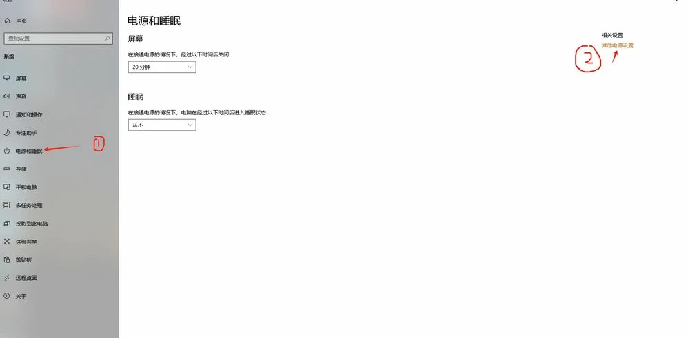

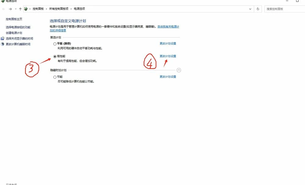

Jul 23, 2025 1:10 AM UTC
会不会是电脑使用了睡眠或休眠模式,可以尝试一下电脑设置微信截图_20250723090629.jpg微信截图_20250723090732.jpg微信截图_20250723090749.jpg
Michael_10-MarbleAuthorAnswer
Jul 23, 2025 4:43 AM UTC
I've removed hibernate as an option in the sleep settings and also set the display to never turn off on battery and plugged in.
