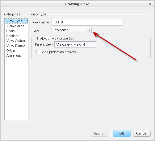

hello,
I have 6 sections views on a drawing, when I drag the views to re-arrange their location they seem to snap onto some invisible grid on the drawing. is there a away to turn snapping of drawing views off?
thank you all.

StephenW
June 2, 2017
Projection views "align" with the view they are created from. If you don't want a view to be a projection view, change it to a general view in view properites.
