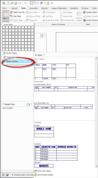

Creo goes to not responding mode after click on Table menu
The CAD data is saved on shared drive.
When we open the drawings and click on Table Menu, it shows the spinning logo initially and creo goes in not responding mode for around 20-30 min. I am using the Creo 2 M120. I have tested this issue with M070 and it shows the same behavior. This happens on Dell and HP hardware.

In Creo Parametric 1.0, when the ribbon and tabs were introduced, PTC introduced the cascade gallery for Table > Quick Tables. The gallery shows a preview of the tables in the pro_table_dir, along with previews of recently used tables, system table etc., making it easier for the user to choose which table (s)he wants to insert in the drawing.
As out of the box there is no value set for pro_table_dir option in config.pro file, so its look into working directory which having around 16k files in our case. This is the reason Creo goes to not responding mode after click on table menu and takes around 10-30 min time to get it back.
The workaround on this issue is set the empty folder/directory for this option so Creo will not search the Working directory.

The only option is to debug the problem. There isn't a delay-table setting.
1) Does this happen on freshly created drawings?
2) Do the drawings have associated models?
3) Are the tables Repeat regions?
4) Does this happen if you do a back-up of the drawing to a local drive and retrieve from the new location?
5) What does Process Monitor show is happening?
6) Were these drawings made with an older version of Creo/ProE and are just now being opened?
7) Was Creo put on the computer as a clean install? People doing manual copying miss parts and this produces weird results
😎 Is Creo installed locally?
9) Is the license manager installed locally?
10) Is this the same on all the computers or is this only tested on one computer?

Where was the working directory?
Devidas1-VisitorAuthor
Mar 20, 2015 6:51 PM UTC
Working directory is set as Shared folder and which having the 16k Files.
