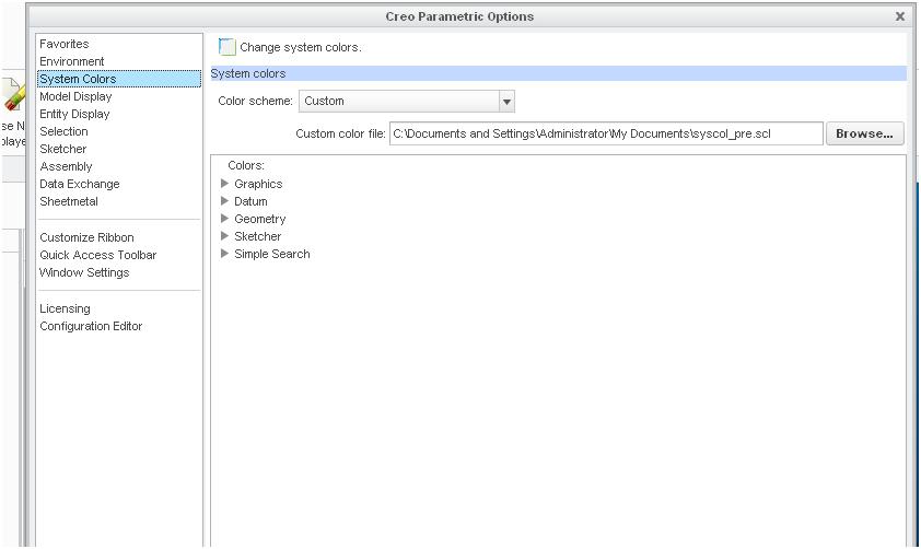

he can very much use the color interface of pro/engineer wildfire in creo 2.0.
I have attached the pre-wildfire and wildfire 4.0 system color file which can be used instead of the white back ground.system_color_file.JPG

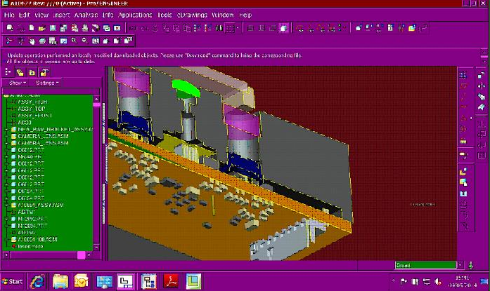

We can control the colour of the graphics window and the entities etc but we cannot control the colour of the model tree or message lines.
This is what he had in Wildfire:

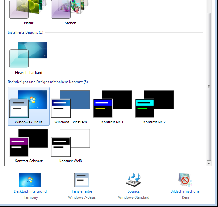

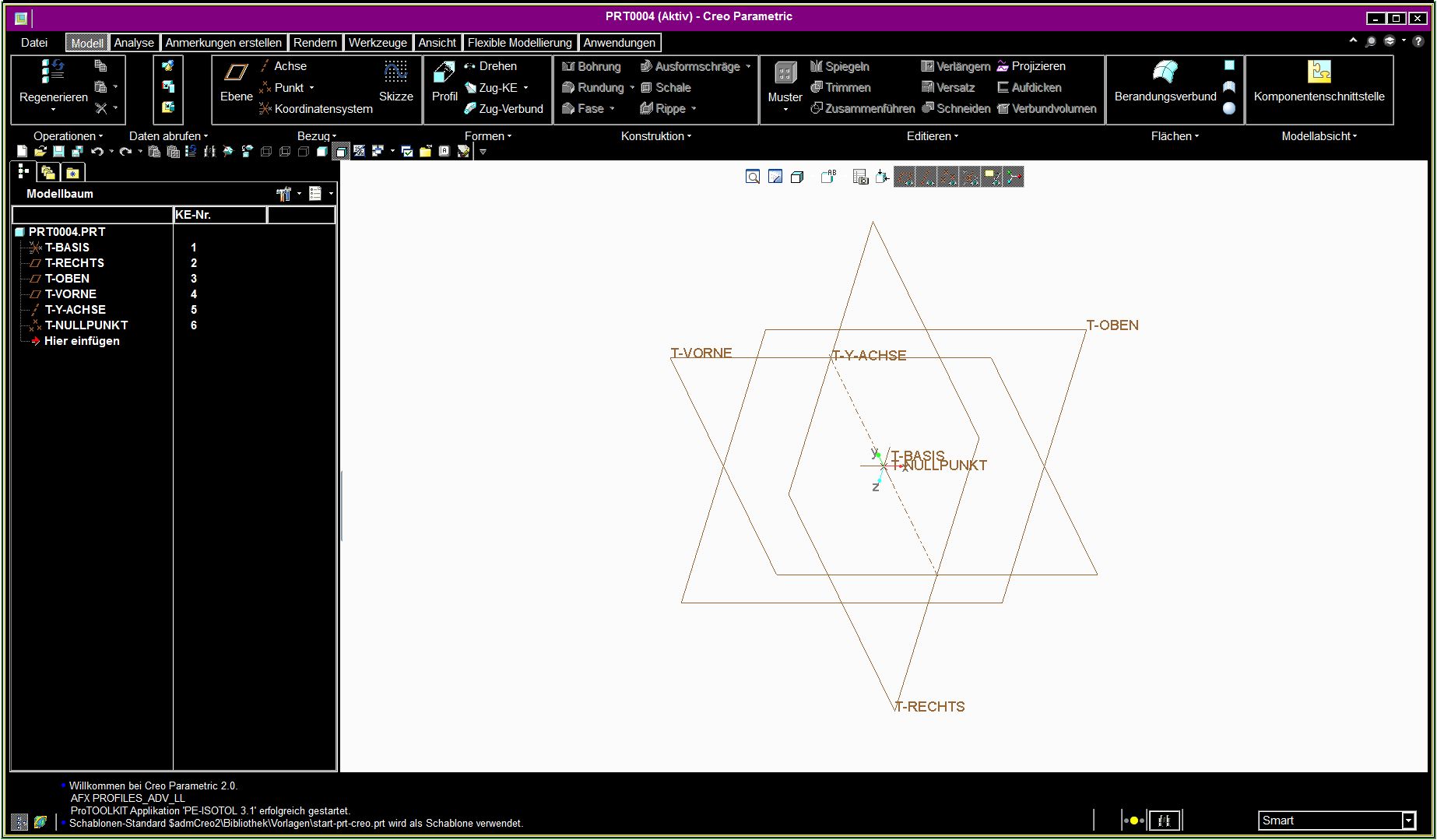

I think this problem has been solved by now but maybe the system settings for windows can help here:
In Win7 you might switch the "Basic Design" to something with more contrast. But of course this affects all other applications as well. (sorry for the german interface in the figures)

Image which was uploaded from Wildfire was due to Theme in OS, There were some options available in XP not sure if all of the options are available in Windows 7 or not.
