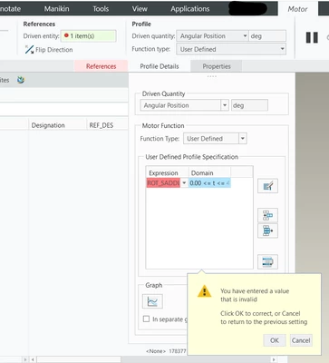

Creo Kinematics, "Entered Value is Invalid" issue in motor definition
Hi, I have developed some mechanism in Creo4 by linking to the parameters and it was working fine.
Now we have updated to Creo8 and when I try to update my expression it shows "entered value is invalid". Could you please support on this issue, thanks.

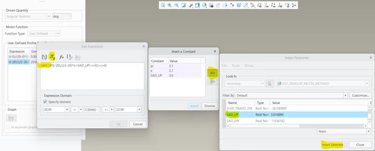

Apologies, I have missed a procedure to add the parameter before using it in the motor profile. As shown below, after we inserted the required parameter, it is recognized in the expression and the issue is resolved.
