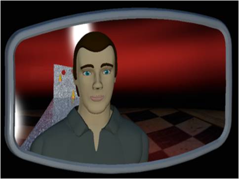

Thanks for the reply, and the link...I'm not terribly familiar with the rendering capabilities, and we do not currently have the Photolux license, so I was thinking maybe it is something I am unaware of and/or missing. I spoke with a PTC rep a few weeks back on this subject, and he explained there were some bugs (in some cases, the manikin's head will not show in the mirror's reflection), but it sounded like the mirror should show some type of image, and I'm not concerned with 'seeing" his reflection anyway...

There are two topics covered in the brochure - one is that the Manikin view uses mirrors; the other is that the Manikin itself is visible when rendered.

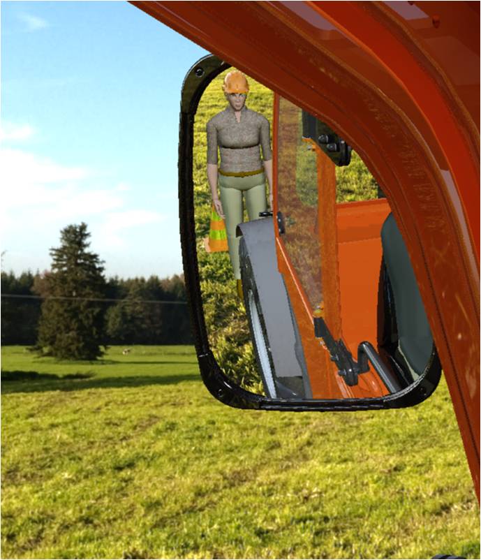

"Engineers/designers can also take advantage of Creo Element's mirror reflection capability to determine what a manikin can see while looking into a mirror, such as in the example at right, which shows what an operator of agricultural machinery can see in the mirror. The designer can also determine whether the manikin could use a mirror to see a small remote part in an industrial engine bay."
The image showing the manikin's head in the brochure is demonstrating that the Manikin is an actual model that can be used in any way any model might be used.
