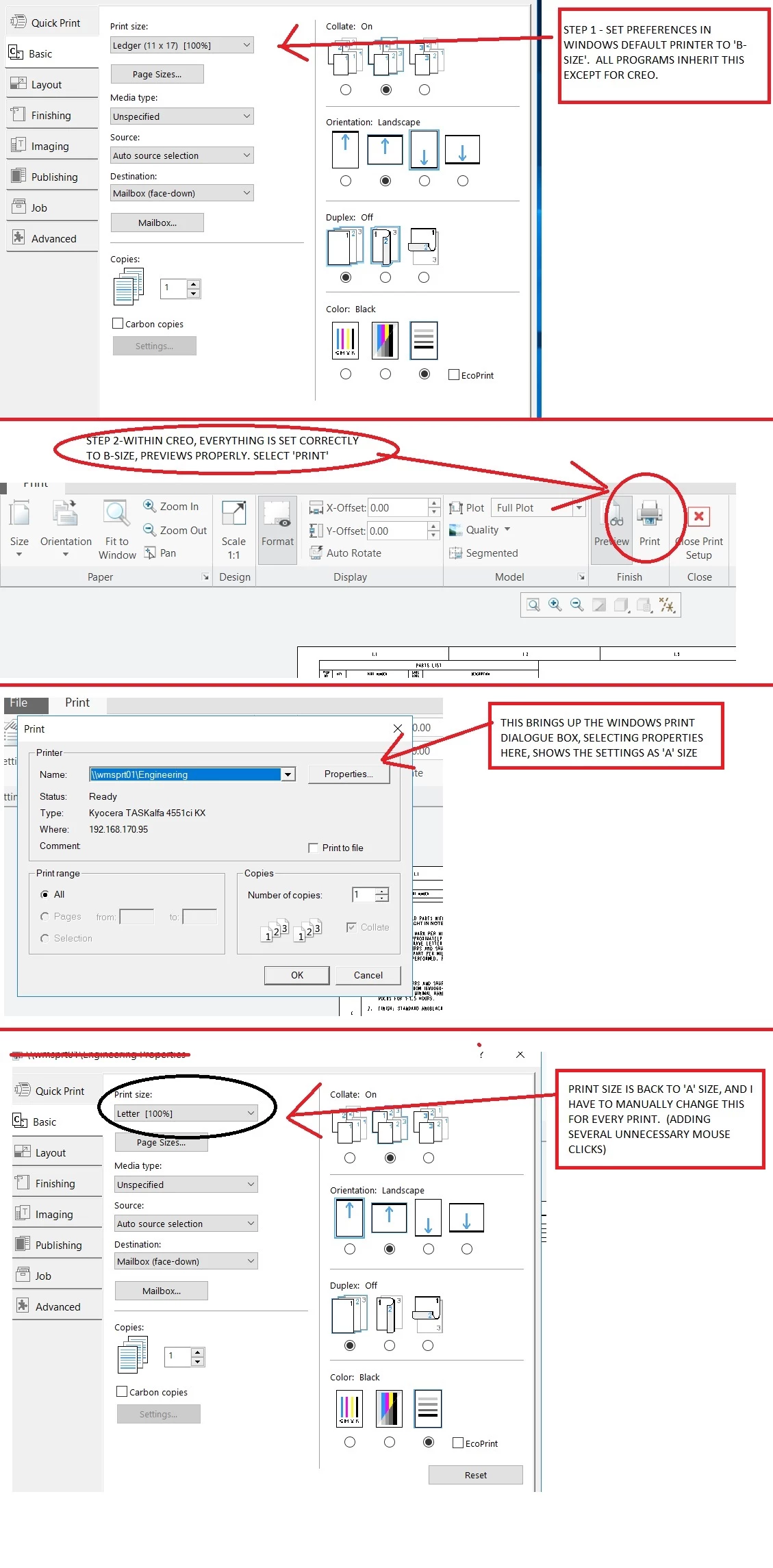

I have my Default Windows Printer preferences set to print 'B' size.
When I print from Creo 4.0 M050 (also set to 'B' size within ), after selecting 'Print' I have to manually set Printer properties to 'B' size every time.  (I did not have to do this in previous versions of Pro/E prior to Creo 4.0)
Every other software picks up the system default settings (ex. MS Word, Adobe, Paint,etc), except for Pro/E.  See attached Image.

That changes the print size within Creo, which I don't have an issue with.  Its the size in my system printer properties.
