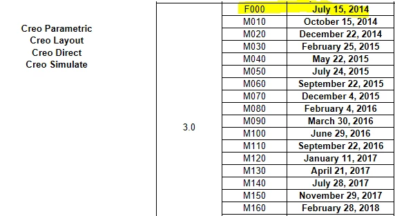

In Creo 3.0 F000, when I first open "sketch" mode and sketch line, circle etc and when saving, creo does not responding and hang it.
Then I have to forcefully close from task manager.
But, when I open "Part" mode and draw line, circle etc. with extruding it and saving, no any error occurred. And if I open "sketch" mode after "part" mode opening & closing, no any error occurred
I think something went wrong with the "Sketch" mode only.
Please help us.
March 19, 2018
You are running an extremely old build of Creo 3.  Please update to something more recent.  This issue does not seem to be reproducible in Creo 3.0 M150.
