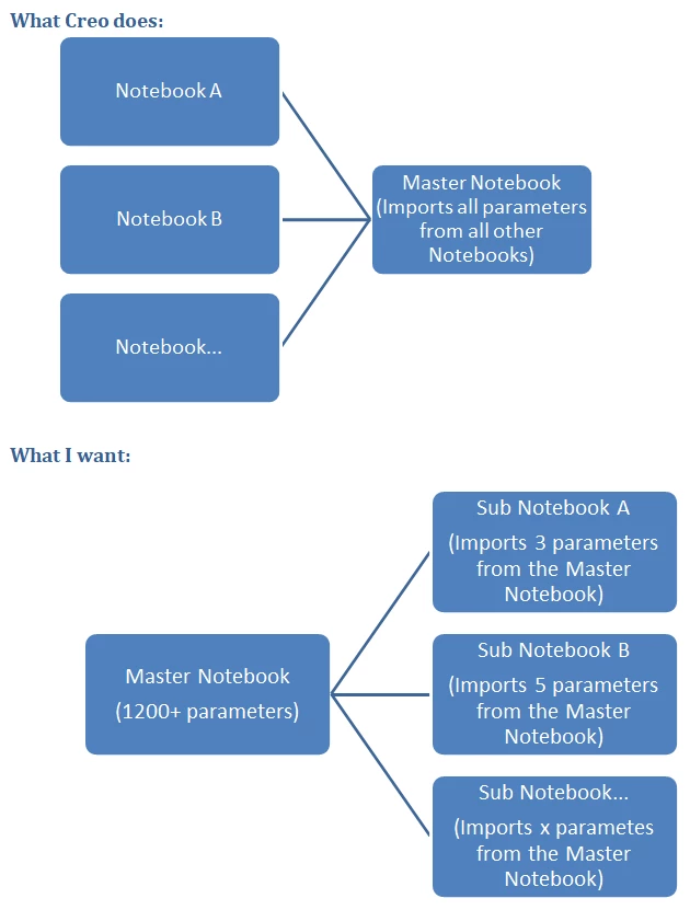

Another option is to declare a Notebook to another Notebook, but it looks like that Creo is the "wrong way around":
And the PTC employee assigned to my case is out of the office till the 24th, so I will need to wait a few days before they can give me an update...
To be continued!
