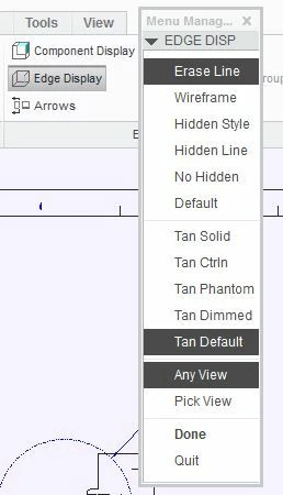

August 23, 2017
Try Edge Display.  You will have to select every line you want to remove.  This tool will also allow you to change line styles and show hidden lines.
KenFarley

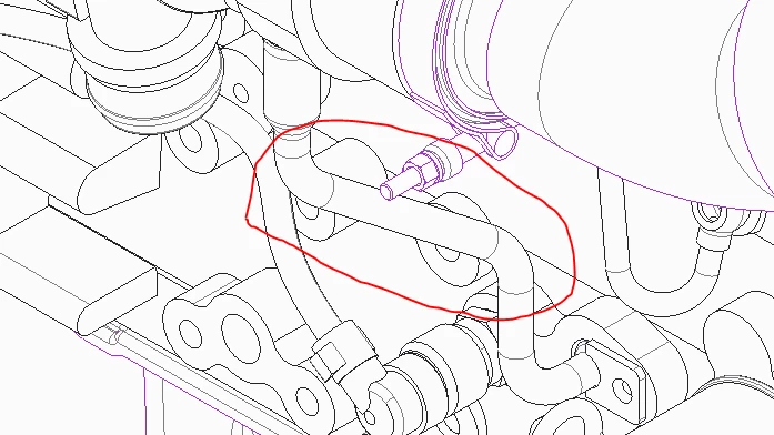

Hi all,
Thanks for the reply.
I have one query is it possible to remove the Pipe, Cable bend lines automatically from drawing. I looked up in the config setting but didnt find any options.
With Regards
Aghil.M
