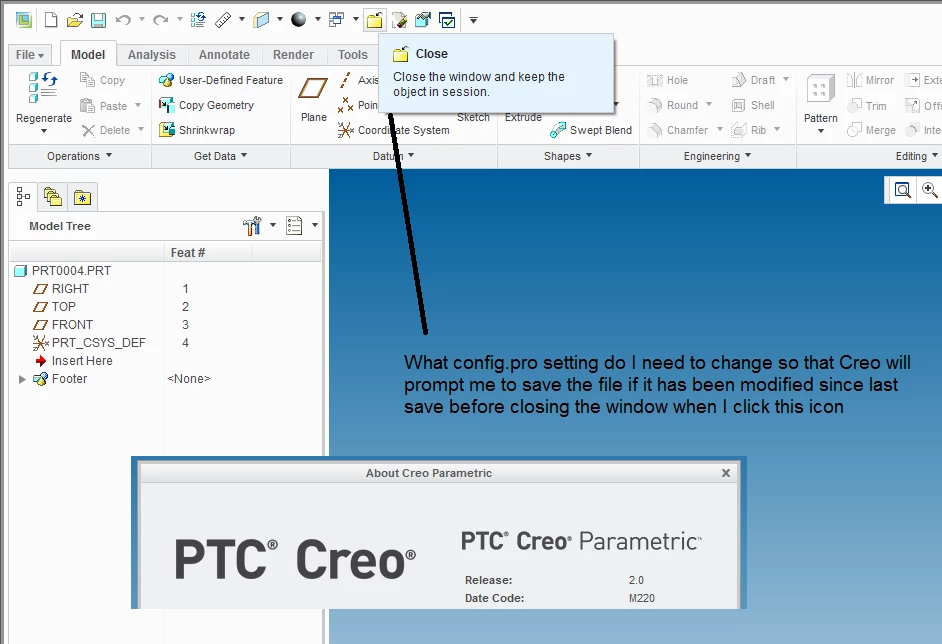

Sorry for resurrecting an old thread, but I can't seem to find my answer or start a new topic.
This is driving me insane and I have lost so much work because of it.
What config.pro setting do I need to change so that PTC Creo 2.0 will prompt me to save the file if it has been modified since my last save before closing the window?
I have tried turning prompt_on_exit to yes and prompt_on_erase_not_disp to yes but that is not what I am looking for. Hopefully the attachment below clears things up on what I am trying to accomplish. I don't want to be able to close a window, either from that file or the normal windows x in the top right corner without being prompted to save. Surely there is a way to accomplish this?
November 8, 2018
Sorry, this does not exist.  The closest you can get is "prompt_on_exit" which you've already mentioned.
