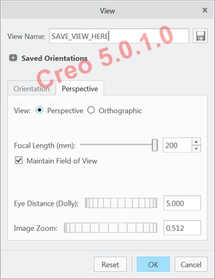

Hi there,
Is it possible to save a set value for the eye distance in the perspective settings in config.pro?
Best answer by ckeller

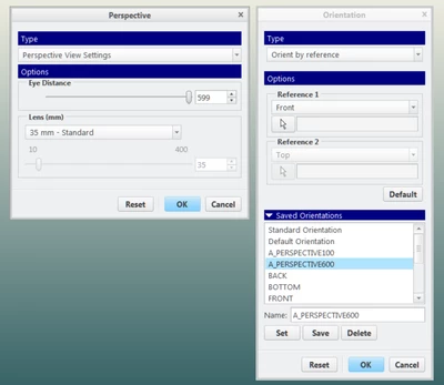

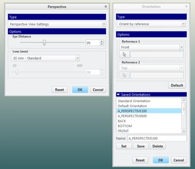

the perspective view settings are saved when you save the view.  change the perspective mm to whatever, then save the view.  then change the perspective mm to something else, and save the view.  you can switch between them with that.
The procedure is slightly different in the latest Creo 5.0.1.0  as they have combined the view orientation dialog and the perspective view dialog into a single dialog.
hope this helps.  if it does, please be sure to mark as solved.
