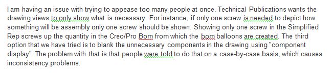

How can I create a Creo/Pro Bom, which references the simplified rep for the bom balloons but shows the quantity of the master rep?Capture.JPG
Sorry, the back story has been insertered into this message as a picture because it won't let me paste from Microsoft word into the message box and I'm definity not re-typing that into here.

I'm really just looking for a way to add a column to the repeat region that references a different rep than the rest of the table.
