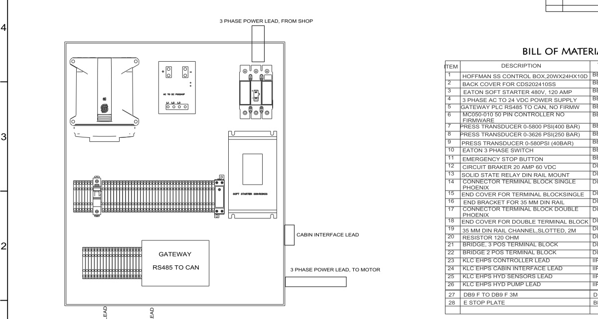

one thing I can not understand is why it is not possible to import *.drw drawings direct to Schematics (without buying the interface to migrate from schematics to elements), does not make to much sense to me since both softwares are made by PTC.
I mean you can import dxf,dwg files so why drw files are not allowed? after all if a drw is imported to schematics you can have a choice to break the embedded features of the drw file, right?
for my projects I use both CREO Elements and Creo Schematics, lately you can download a lot of 3D models of electronic/electrical parts.
so in order to create the BOM and a layout of how parts are set up I have to convert from drw to dxf and then import to schematics, this may not take that long but why it has to be like that since the same company makes both softwares?

and what I said they can add a choice to break the embeded 2d drawings, it is like when you are in Creo Elements, you can copy a full assembly and you can choose to remane all parts or use it as it is. if you choose to rename the parts they are totally different assemblies.
it is just a thought that comes to my mind everytime that I need to represent and artifact in creo schematics.
The picture attached shows you what I am talking about. I did the 3D of that control BOX so that I can figure out the arragment of the components and also if all that would fit in the box.
That picture is used by the assembler to do the job. so I had to export the drw to dxf then edit in dxf then insert in creo schematics. it may not take too long but could be easier, isn“t it? CREO_SCH.jpg
