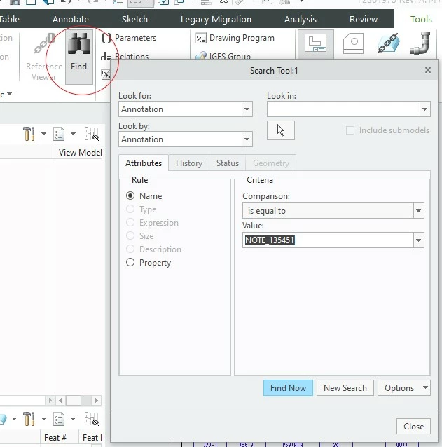

Does anyone have any good experiences using the "Find/Search" function within Creo Drawing?
I'm currently trying to use it and I realize it sucks pretty bad. I'm thinking it must of been designed by Microsoft.
Anyway, I've got a drawing with multiple sheets of tables on it and I'm trying to do a "text" search to find specific things within those sheets of tables but to no avail. See attachment.
-CR

May 23, 2023 7:54 PM UTC
I don't believe the find tool was designed to find text as you are trying to do.  It finds features and entities.
I would suggest creating a pdf with searchable text and use that.
May 23, 2023 9:07 PM UTC
Yes, I thought that might be the case. That's been my workaround is creating a PDF like you recommended. I was just curious about Creo's version of search. It's disappointing but I'm not surprised.

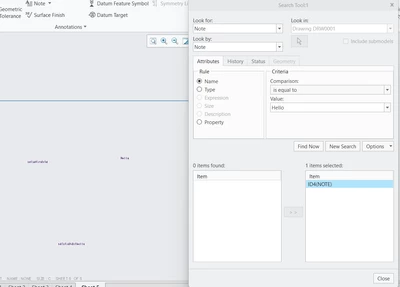

May 31, 2023 9:40 PM UTC
Hi @CR_9888056
I was able to get the desired results, Screenshot is attached.
By taking a closer look at the image attached, I have noticed that you have not selected the 'Look In' in the top right corner.
May 31, 2023 11:18 PM UTC
Thank you for checking. Unfortunately I can't get it to work right on my end.
It seems the Find function does well with finding geometries & dimensions but does very poorly with notes and text.
Another drawback is in a multi-sheet drawing, it lacks the capability to take you to the specific sheet an items is located.
I guess I'm spoiled by Word and Excel. Sadly, AutoCAD has a far superior search/find command too.
I know I can convert a drawing to PDF for better search functionality, but I wanted to see how well Creo's Find command works.
