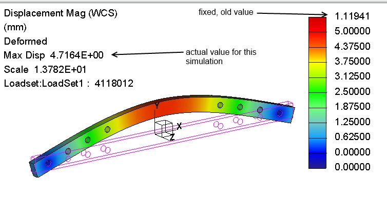

I created a result window template with, amongst others, the option 'legend values'. (Easy when comparing different designs, the color code has the same values). When reusing that template, the maximum legend value is the same as that one result from which the template was created. It won't update.
This seems a bug, to me. Is there a solution or a work around?
