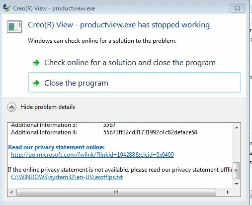

Hi all,
One of the Marketing person was using Creo View 2.0 without any issues but now when we try to open pvz file it gives attached error saying Creo(R) View - productview.exe has stopped working. I deleted all adobe applications from machine since someone else similer probem got fixed with it but in my case it's still giving same error. Does anyone has similar situation.
Thanks in advance
Problem signature:
  Problem Event Name:                        APPCRASH
  Application Name:                             productview.exe
  Application Version:                           10.1.20.15
  Application Timestamp:                     5047800b
  Fault Module Name:                          ig7icd32.dll
  Fault Module Version:                        10.18.10.4425
  Fault Module Timestamp:                  5702a994
  Exception Code:                                  c0000005
  Exception Offset:                                00137d9d
  OS Version:                                          6.1.7601.2.1.0.256.4
  Locale ID:                                             1033
  Additional Information 1:                  0a9e
  Additional Information 2:                  0a9e372d3b4ad19135b953a78882e789
  Additional Information 3:                  0a9e
  Additional Information 4:                  0a9e372d3b4ad19135b953a78882e789
Mahesh_Sharma
22-Sapphire I
January 22, 2018
This seems to be sue to Intel drivers as Fault Module in details is ig7icd32.dll, related to Intel.
- Try clearing cache under %AppData%\Roaming\PTC\ProductView
- Try updating graphics driver.
