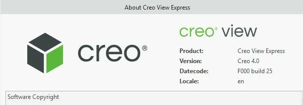

    I can load a Creo 4.0 part file with creo view express 5.0 but not a creo 5.0 part. is there a version issue that PTC does not know about the creo 5.0 version i have loaded is 5.0.1.0 the thing that i noticed is that the build for creo view express shows as Creo 4.0
    Any help.
