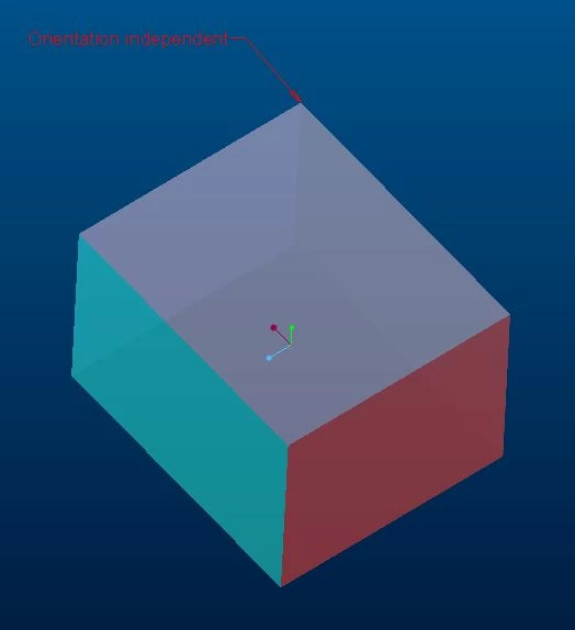

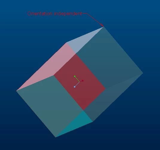

This could be done in ProE WF4, but it looks absent from Creo2. We can even place a 3D Note in the model with a leader but when we change it from a planar surface to Flat to Screen the Leader disappears with apparently no ability to bring it back.
Any ideas on how to get a leader on at 3D note and have it still be oriented Flat to the Screen (meaning you can always read it Left to right no matter how you orient the model)?
See attached pictures for what I am hoping to do in Creo2. These pictures were taken of a 3D note that was done in ProE wf4

I searched this forum using several combinations of key words, I don't know why that post did not come up. Thanks for the reference.
After following your instructions in that forum I am still unable to choose geometry with a leader line. It does snap to the origin when I choose geometry but then I cannot place it at all. You both referenced a video you made but I did not see it there, do you still have it? Or can you direct me to it if it is posted somewhere?
Thanks for your help.
Lawrence
March 14, 2014
Videos have a bad habit of not showing until you refresh the browser several times.
Video Link : 4792
I have attached the video
