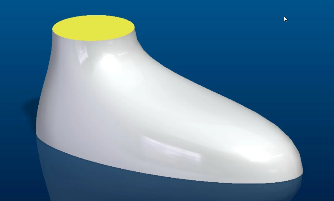

Good morning, I am fighting with a very basic issue : I appreciate the result of shading mode with reflections versus the normal shading, but : a) I need to hide the floor reflections ( I need just the surface part reflections ) b) I need to set the reflection plane as the yellow plane Do you know if/how is possible? thanks

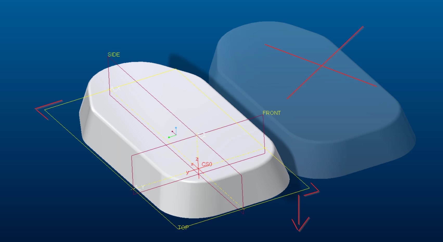

May 21, 2019
