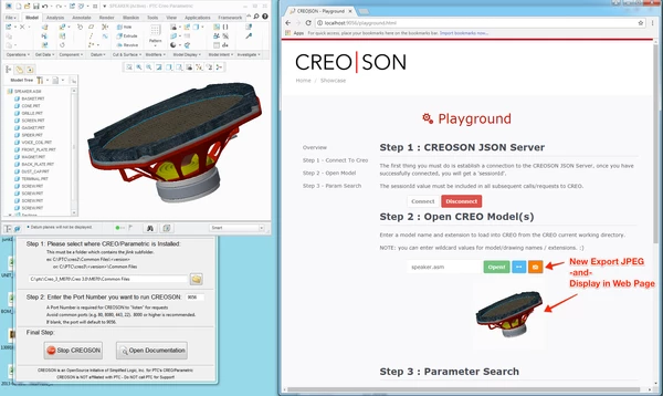

CEOSON is OpenSource Automation for CREO Parametric using JSON Transactions!
The following command groups have been added to CREOSON and are available with the latest BETA Release:
  • windchill (server identification, login and workspace manipulations)
  • drawings (create from templates, sheet and view manipulation and introspections)
Please view the Function list (and examples) within the CREOSON documentation after you have started the CREOSON Micro-Server.
The "Playground" also now includes a nice Image Export Demo after you have opened a file in CREO Parametric. (basically it exports a JPEG and then displays it in the Playground's webpage.)   You can always "right-click" view source in the Playground webpage to see how the webpage functions work with the CREOSON Micro-Server - again -- ALL done with JSON Transactions. 🙂
