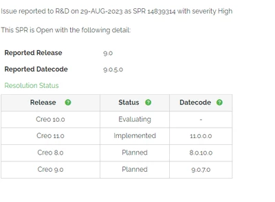

The case of the missing cursor in family tables will be resolved as shown below:
Thanks PTC for fixing this!!!

Dale_Rosema
Aug 30, 2023 3:01 PM UTC
The case has been assigned SPR14839314 with a high level of severity.
Also noted was that when  cell is empty and you move your cursor to the cell using the arrow keys the cell doesn't show any indication of its location.
When a cell has contents, the color flips (black on white becomes white on black).
Dale_Rosema
Jan 3, 2024 4:35 PM UTC
Creo 9.0.7.0 installed today and the cursor is visible when editing a family table cell using "F2".
Woo-hoo. No more playing "Guess where the cursor is in the cell"!
