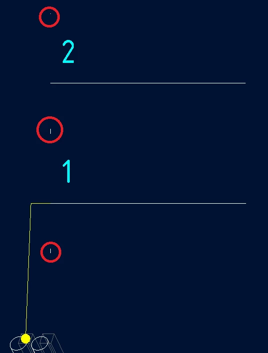

if I understand you well you use circle to enable users to position merged balloons properly.
I think you can replace circle with very small lines located at proper places in symbol definition. Because they are "almost invisible", you do not have to hide them.
Example:

I have spoken with PTC about this in the past. It is not currently possible to hide the circle. The best you can do is to make it really small.
Example:
