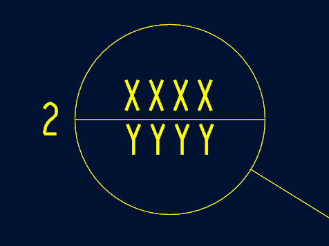

I can't seem to find a way to do this in Creo 2.0, but I need the REF balloon to match my custom balloon.
For reference, my company uses a custom BOM balloon where the part number is displayed in the balloon and the qty is outside the balloon. It looks like this:
I want the REF balloon to look exactly the same but display "REF" instead of the QTY.
Anyone know how to accomplish this?

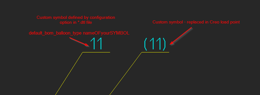

Hi folks,
I have created my custom reference symbol and REPLACED this files in the Creo:
%loadpoint%\PTC\Creo 3.0\%datacode%\Common Files\symbols\report\bomballoon\qty_ref_bln.sym
%loadpoint%\PTC\Creo 3.0\%datacode%\Common Files\symbols\report\bomballoon\smp_ref_bln.sym
Note: default BOM symbol is possible to set in *dtl file >> set configuration option
default_bom_balloon_type custom_bom
