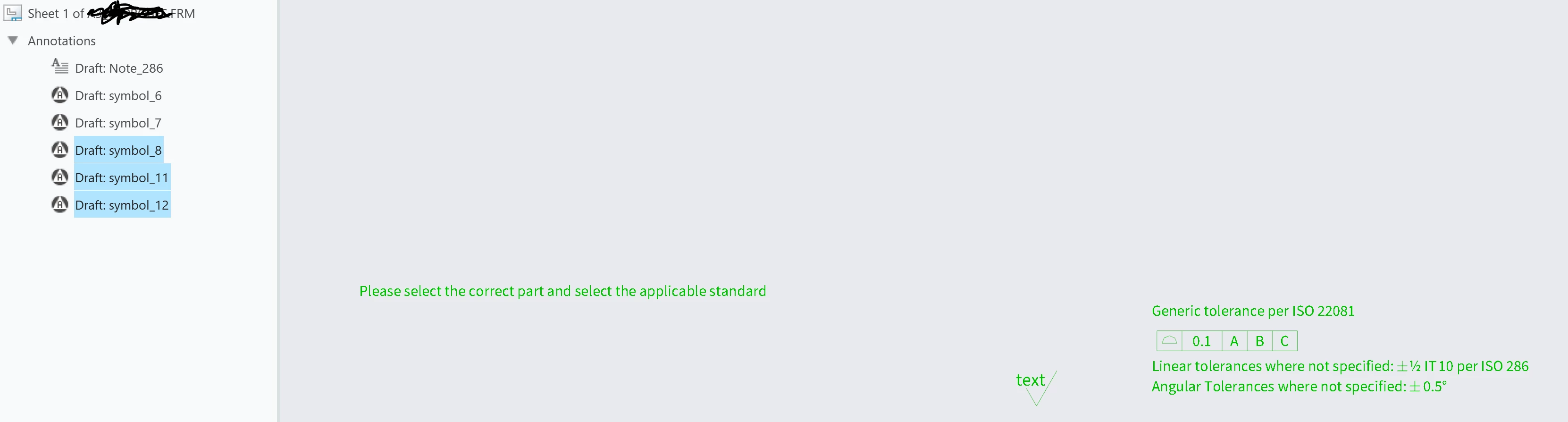

I want to add some selectable notes in the drawing and I succeeded by creating a custom symbol. I can customize it when I am still redesigning the format file, change the values, move it, everything rocks.

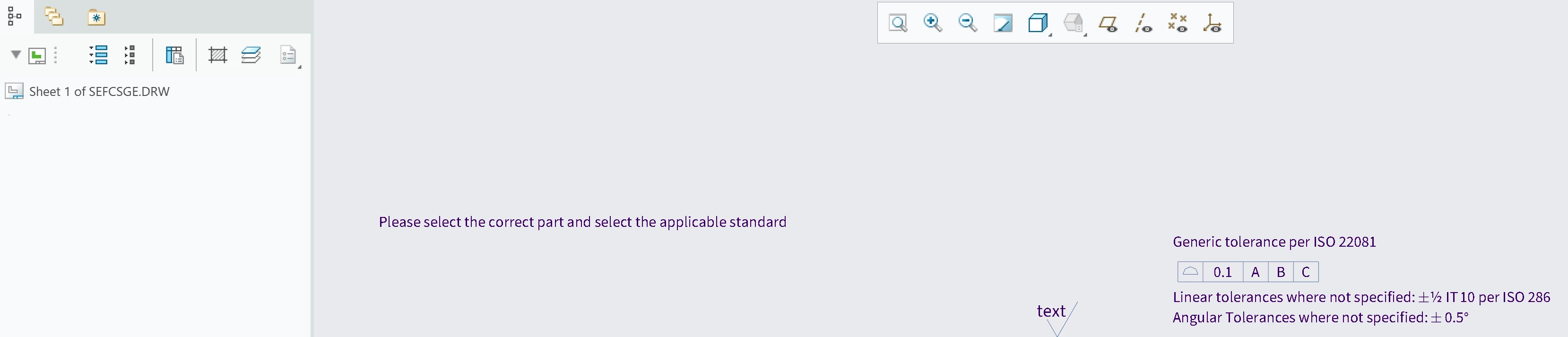

Now when I want to create a drawing with this format, I cannot customize nor move the symbols anymore. They are frozen as they are printed on the paper and I cannot even try to customize it at all as they are not present in the symbol list at all.

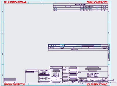

This one of our formats
This the drawing template that we use to create drawings with
The format has the parameters in it.
The template has those values filled in from the parameter table.
