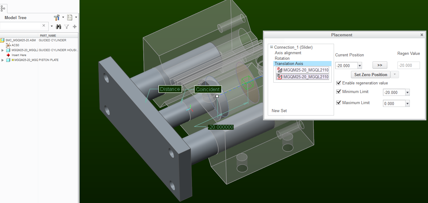

Furthermore, I would suggest that when you are preparing these library components, name this dimension and prescribe it as flexible prior to storing the cylinder in your library.  This will save you and your users from a lot of work and confusion.
Step 1) define the regeneration value to create a dimension that will be "flexible"
Note: I sometimes find definition of "motion limits" in the mechanism joint connection definition a bit wonky when Creo insists of using negative values for direction of travel that I consider to be positive.  There is no option to "flip" the direction, so in the above case, we have the limit of the movement from -20 to 0 (-20 being the "extended" position).  But I find that afterwards, I have use positive numbers to specify the extension distance!  The gotcha is that if you leave your regeneration value at "0": When you assemble such flexible component into another assembly, you will get a regeneration failure because for the inserted instance, the "flexed" distance will have a negative sign!  Anyway, hard to explain and very confusing, but I work around that by putting away cylinders with such negative limits in their 1/2 position - in this case, -20mm.  Then this is inserted into the assembly, the default position will be extended, but you will not have the regeneration failure.

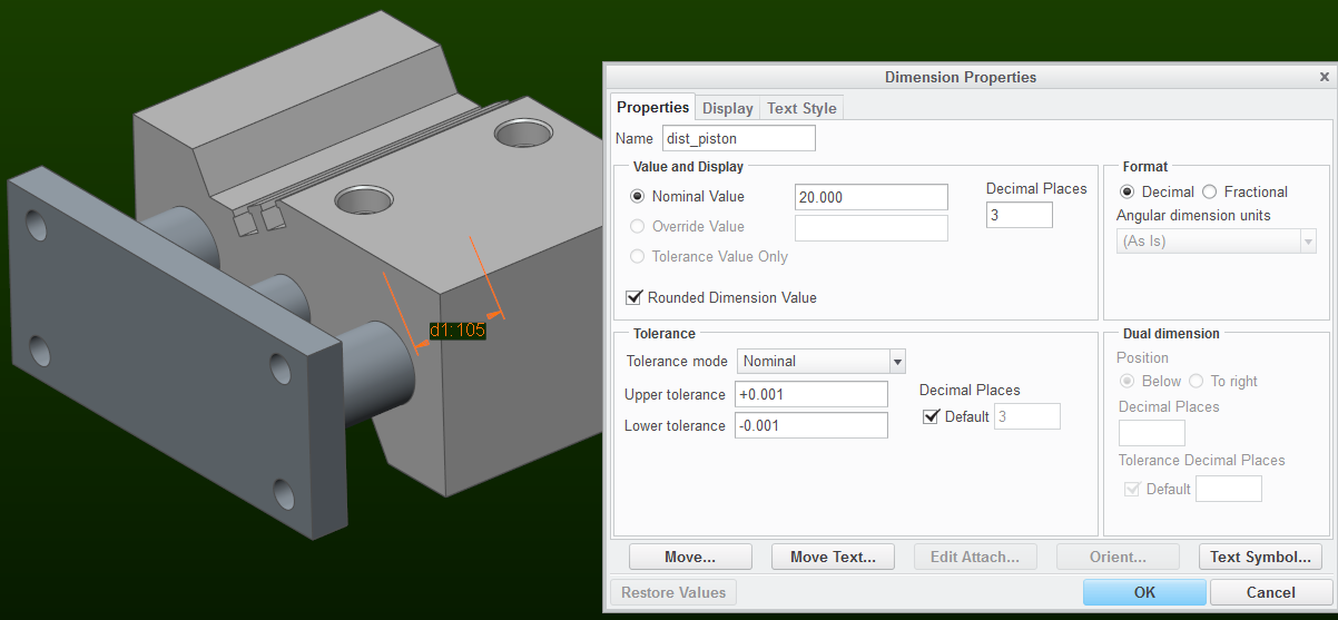

Step 2)  Rename this dimension by editing it's properties.  No one will remember what d1 means.

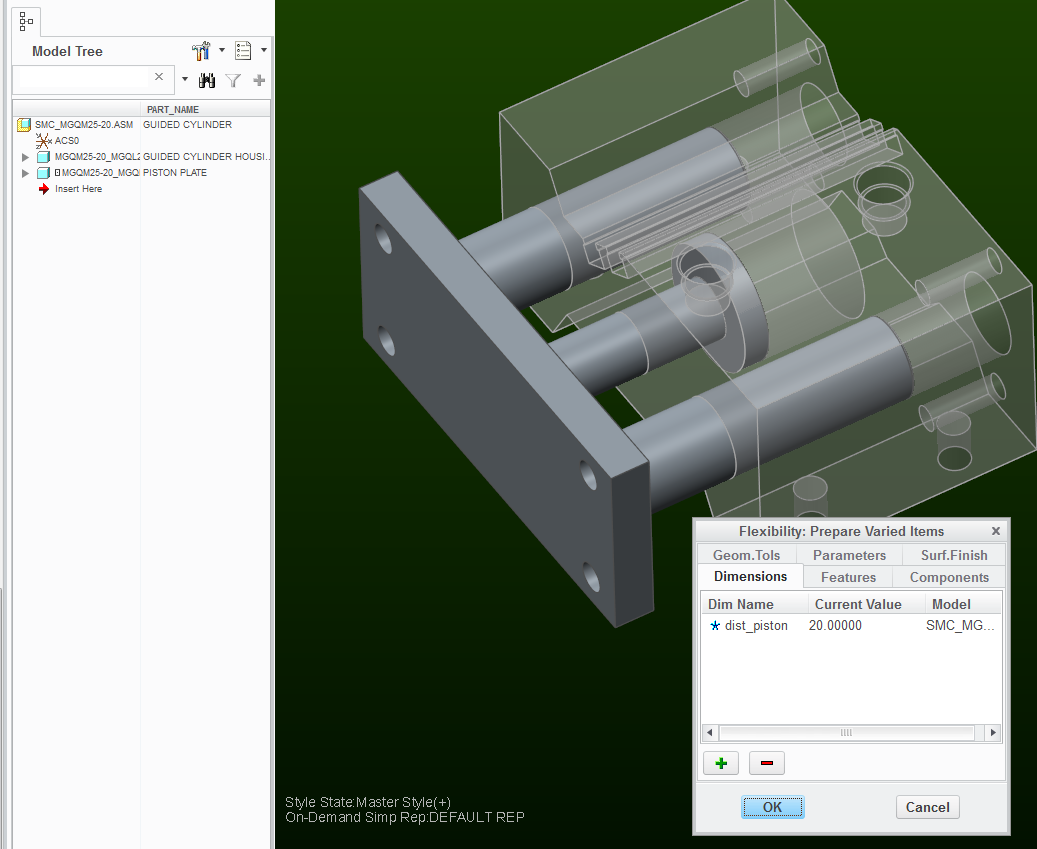

Step 3) Edit the model's properties and prescribe the flexiblity:
Tip: use query-select to get at this "C"omponent level dimension.
December 9, 2016
The FLIP Connection is in the dashboard header and not on the placement tab.
