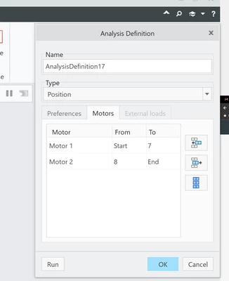

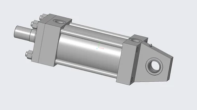

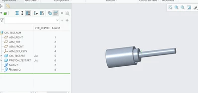

The cyl on the left is from Parker. many parts and features.  Since it was not functioning with the mechanism servomotor using cylinder assembly constraints, I tried slider constraints. This was the advice on many youtube tutorials. Apparently is is more reliable? Not sure why connecting a piston to a cylinder would have trouble using the "cylinder" constraint specifically designed for this. So after many attempts to get the motor to drive the piston out and back I decided there may be issues with the Parker model. I then made the simplified model assembly on the right and went through the process of putting the cylinder on the default constraint then adding the piston using cylinder constraint. Setting limits and testing with the drag function. All good (as before). Now I start mechanism in creo and attempt to assign motors to the cylinder assembly. The motor will drive the piston out most of the way then fail with the errors I listed above. Sometimes there was a " bobble" in the travel and sometimes it would stop part way. When  a second motor was added to derive it back in the opposite direction (home) it would not work. ever. when i set the times in the motor dialog as shown, nothing happens and the values reset to start/end for both motors. The manually entered values always revert to default.
