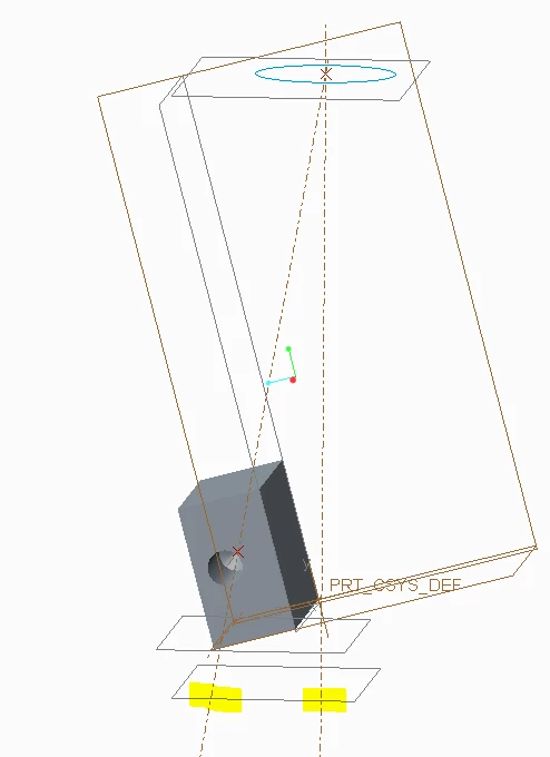

I am looking to make a point on the datum plane shown where the axis datum intersects it. I have tried drawing a point on this plane and using the coincident tool, this seams like it should work but the point moves to a random location.
A bit of background to what im trying to do. Im looking to create a sketch showing where internal feature points would appear on an X-ray image. Any advice or help with this would be appreciated.

Try to select the axis first, then press and hold the control key and select the plane.

Thank you very much! That worked perfectly.
