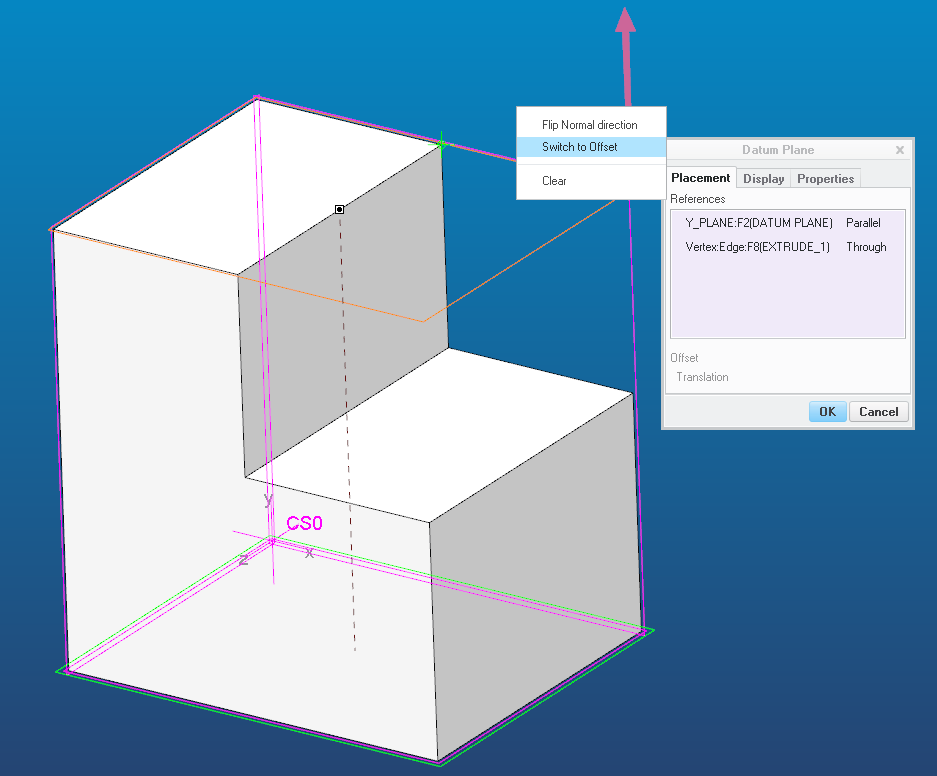

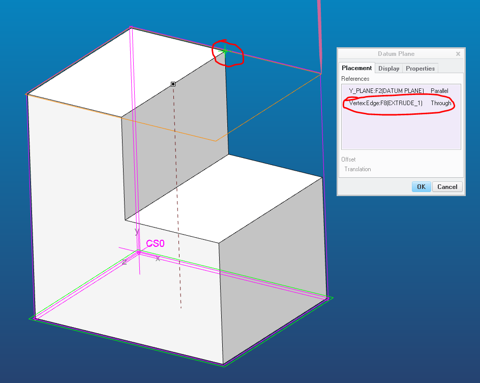

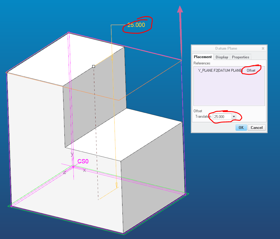

Then I figured out how you can make an offset plane through a referenced point then right click and select change to offset and it will remove the referenced point and keep the offset distance.
