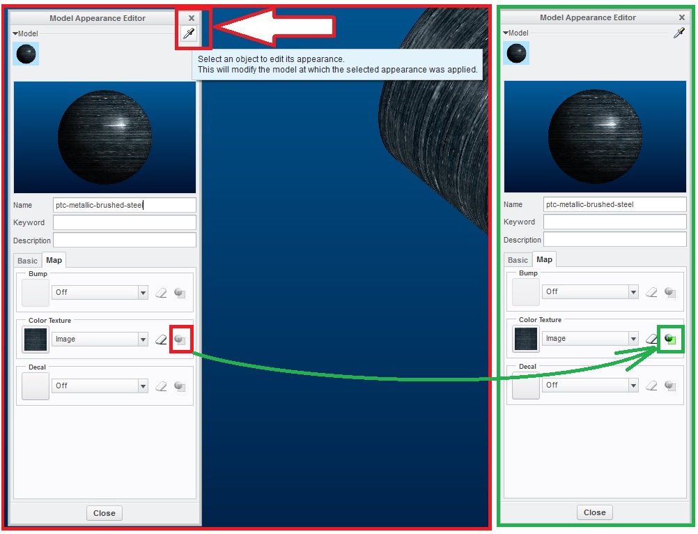

Decal - sometimes the 'eyedropper' will activate & other instances it will not activate.  The decal image *.jpg or *.png will populate, but I can't seem to activate/edit for "parametric/planar/re-sizing" etc.
I've tried create new color on primary surf then ctrl-c, ctrl-v & apply to surf.  Either way, no dice..ideas..

Hello Sean Collins
see "Model appearances editor" upper right corner. There is a "dropper" which is using for decal, color texture and bump editing.
1. click dropper icon
2. select desired surface
3. decal editing button should be active
Hope it can helps...
