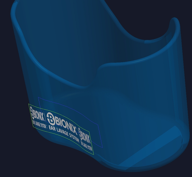

I am trying to place a decal of some artwork on a quilt of curved surfaces (offset 0.005" so no color bleed through), but I cannot seem to get ProE (WF 5.0 Foundation XE) to see the offset quilt as one single surface. The placement result I get, seemingly no matter what I do, is to have a copy of the artwork on each individual surface of the quilt. I would really appreciate some advice on how to place one copy of the artwork over the entire quilt. FYI, I have no problem placing the artwork on flat surfaces, only on the curved.
Here is an image showing the placement result I am getting:
Thanks for your help!
