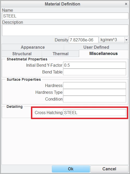

Someone just asked me a question about setting the default x-hatching. I had never thought about it but we often change the x-hatching on a drawing to steel. I use a mapkey to do this but if there was a way to make the cross hatching default to steel, that would make at least one user happy.
March 27, 2018
I setup all of my material files with crosshatch definition, so when I assign/change the material, the crosshatch automatically updates to the ANSI/ASME standard for that material.

Hmmm, we don't use the material assignment here. I will look in to this to see if I can take advantage of it though. It may be worthwhile to use it depending on the benefits I can get out of it.
March 28, 2018
following picture belongs to CR2 M070
Creo will use steel.xch hatching pattern in this case.

A bit of an old topic, but something that just came up with us as well. We recently started using the material properties to assign hatching to parts. Using the config file option "default_hatch_type PAT" seems to make it so when you create a new section, it's based automatically off the material assigned. This seems to only work on the part level and not on assemblies: does anyone know why this is?

We assigned a material (ex: steel) to a part that defined the crosshatching. When we create a new section, the cross hatching is automatically set to steel. This is only the case with "default_hatch_type PAT".
We create a new assembly with the previous part. When we create a new section, the cross hatching isn't set to steel. Is there a way to keep the cross hatching we had from the part?
Most of our components are steel and it would be nice if we could default the hatching to steel (unless otherwise edited like the angle or scale).
