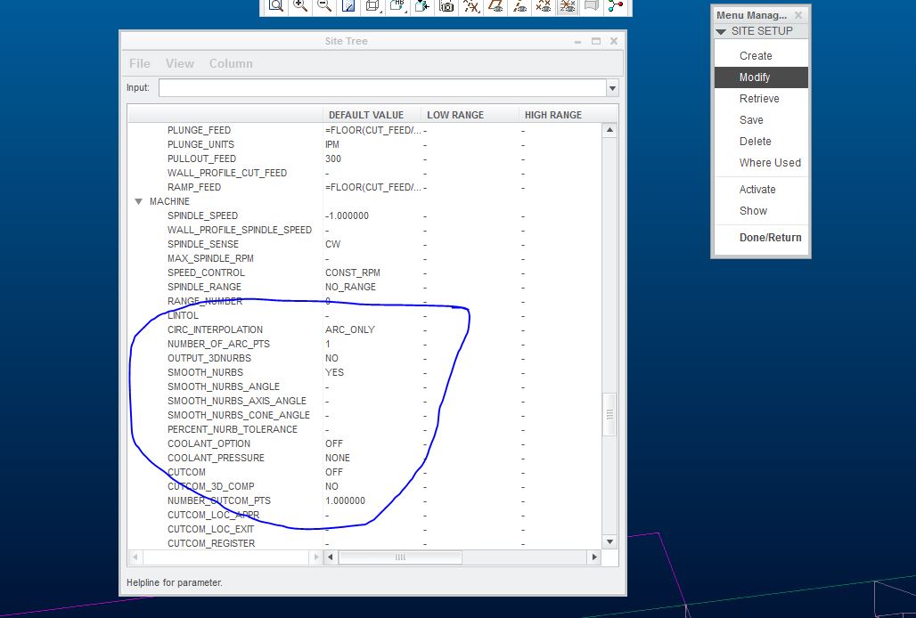

Hi i'm just wondering if there's a way to set default parameter conditions for my manufacturing processes.
Eg, setting Coolant to 'Mist' by default,
setting Circular Interpolation to 'Points Only' by default.
These are just a couple of the settings I would like to customize so I don't have to keep changing them in every single process I create. It would also be nice for other people that come and program for my machines, so as not to get mistakes when machining.
I forgot to mention im using Creo 2.0 Manufacturing
Best answer by SteveLucas
Nick,
You can set the parameters in the site files for your default values. You can have a different file for each machine also. At least that is where I set parameters for my machines. I have a different site file for each machine with slightly different parameters.
Steve

Nick,
Steve
August 19, 2014
Oh awesome thanks so much this is gonna save me sooooo much time!
