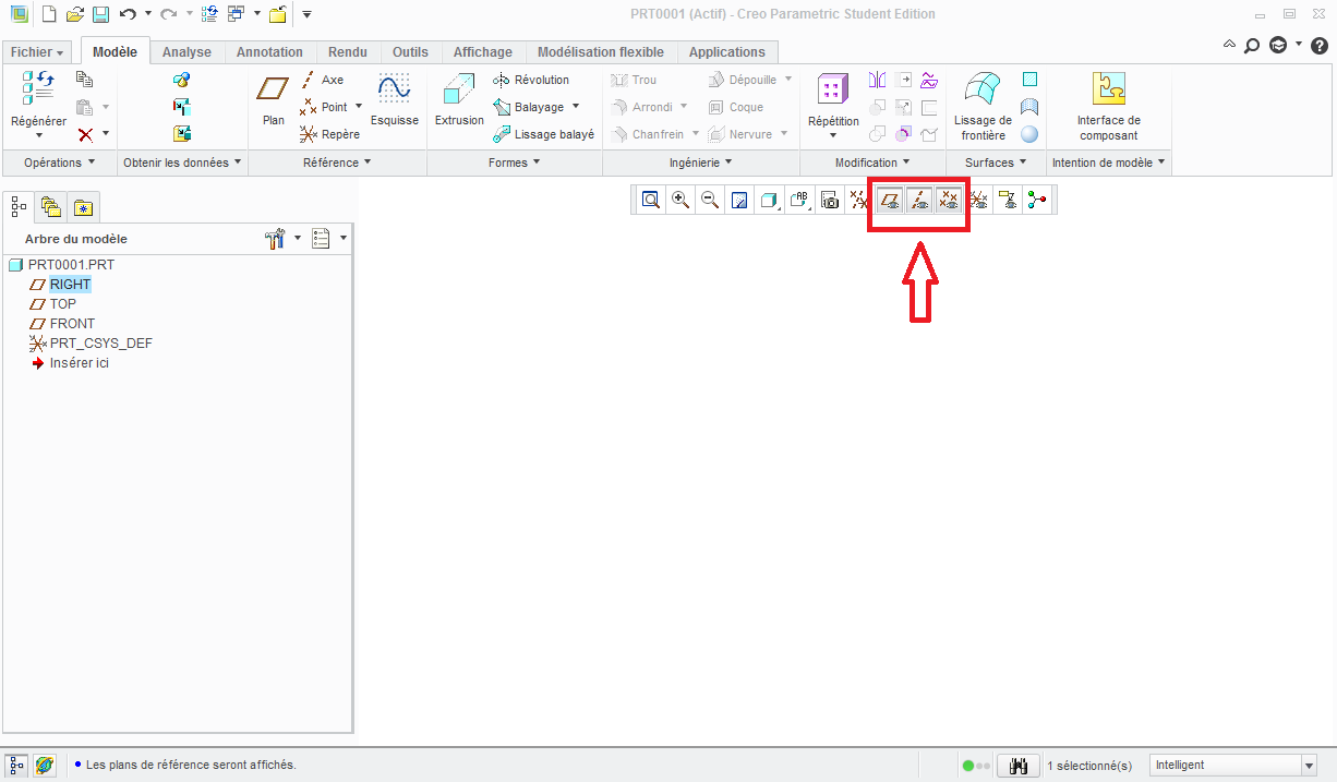

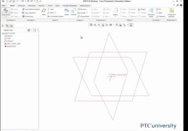

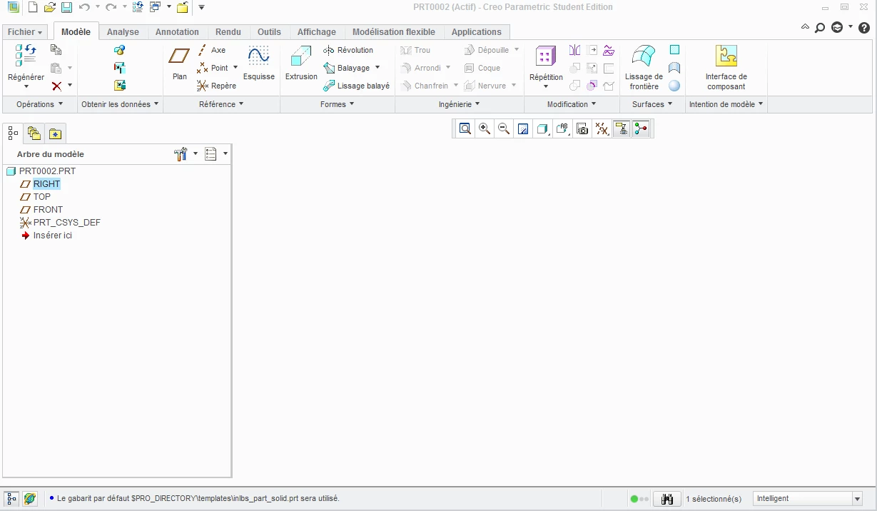

I just installed Creo 2.0 (student edition). When I model a part, I dont see any reference plane in the modelisation window. I see the ''RIght'', ''Top'' and ''Front'' plane in the model tree, but these are not visible in the mod window. I think if you look at the screen shots in attachment you should understand my issue.

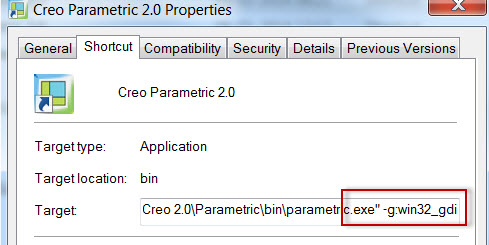

----- Rename config.sup (if any) in <Creo 2.0 Install location>\Common Files\M110\text > launch Creo and check the datums.
If still fails, move to below steps.
Next step:
Remove the one in list.
1. Right Click on Creo 2.0 shortcut icon > Properties
2. Click in Target path and move cursor to extreme right (at the end of .....exe")
3. Add a space after .exe"
4. Type -g:win32_gdi > Apply > Ok

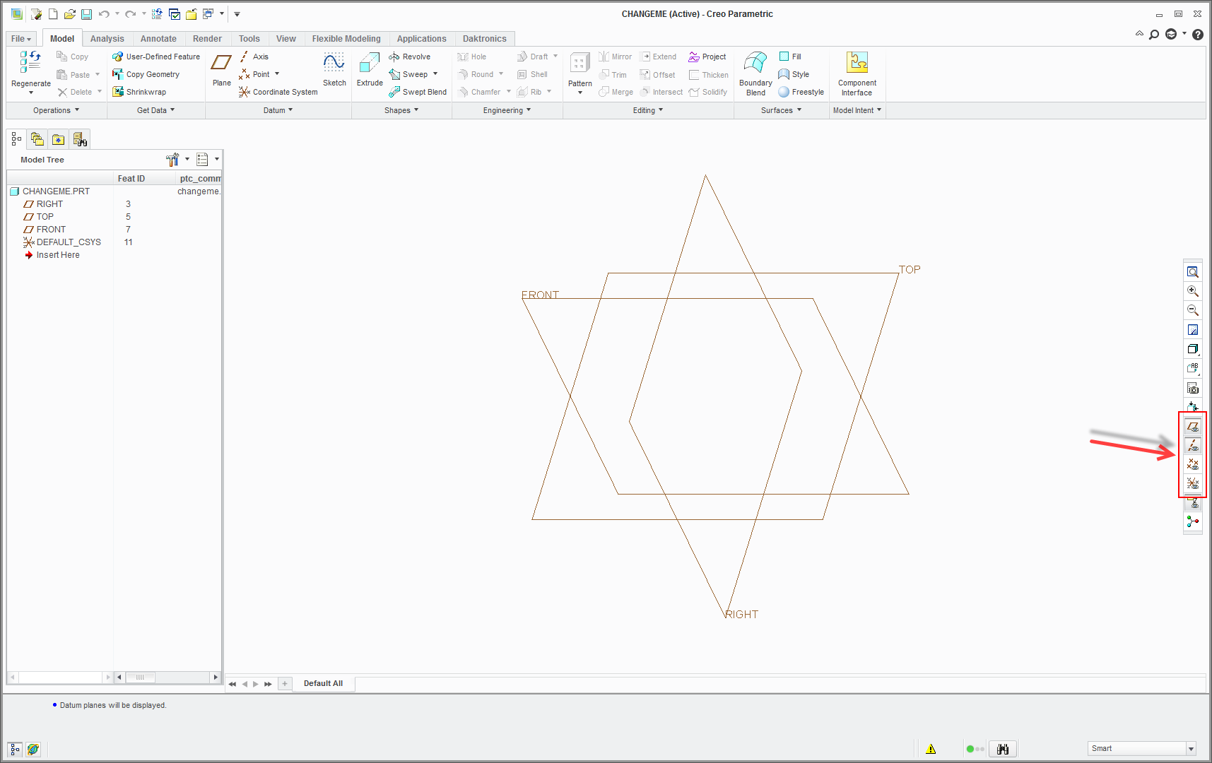

You need to turn on your datum display. Probably in the top center of the window in a fresh install.
gduval1-VisitorAuthor
June 24, 2014
Thanks for trying to help, but as you can see, I still don't see the planes even though theses display buttons are turned on. What+I+see.PNG

Guillaume,
This seems to be due to graphics.
Add config option graphics win32_gdi in config.pro and relaunch.
You can directly add that in config.pro available in <Creo 2.0 install>\Common files\<datecode>\text\
