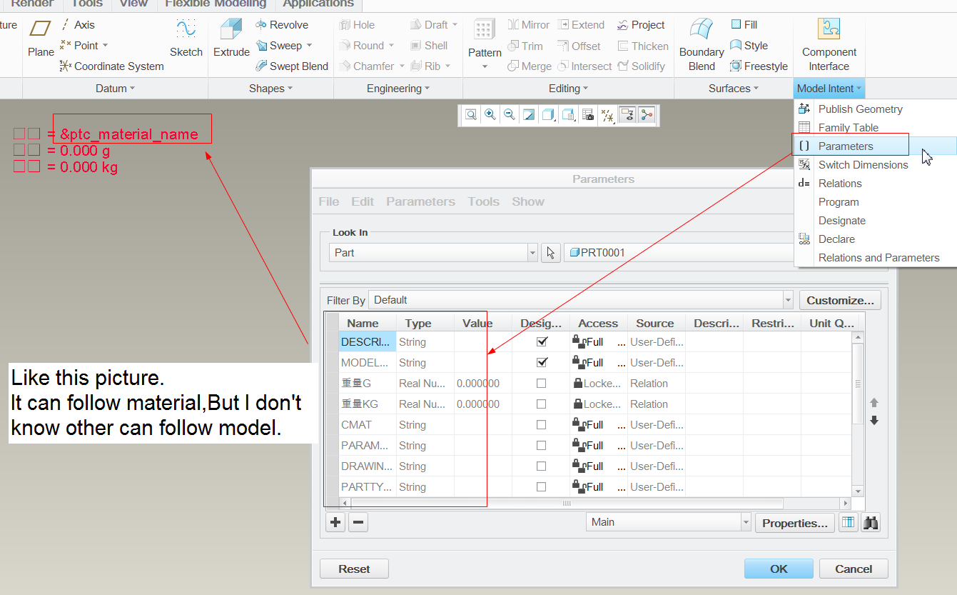

How can I use parameters of Modeling fuction? I don't know which ones ? what's default parameters.I just use &ptc_material_name that follow model. It's default parameters, I don't know other default parameters that follow model. Anyone can tell me. Thank you very much

When you have your default template open, you can find your default parameter set by selecting the "Tools" tab then in the Model Intent section of the ribbon, you will find and select "Parameters".  A separate window will appear with all the definitions.
Should you open an active object (other than default) and follow above instructions, it will show the default parameter set plus any other parameters defined for this object.

But I need the fuction for this picture
System & Model Parameters
This topic fits my needs,But I needs all Parameters‌ that follow model.

empty model contains no parameters. User has to define all requested parameters inside the model. There are no system parameters.
See http://help.ptc.com/creo_hc/creo30_pma_hc/usascii/index.html#page/pma/fundamentals/fund_seven_sub/Using_Parameter_Symbol…
