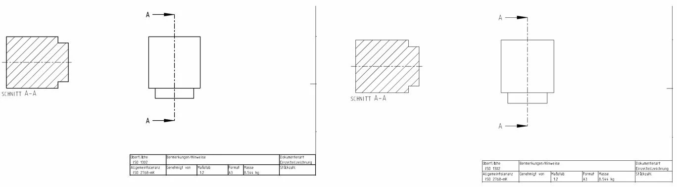

If I change the model edge thickness in the pen table, the table edge thickness is changed too. How can I change the model edge thickness without changing the table edge thickness?

by default table lines have Letter color assigned. Entities colored with this color are drawn with pen 2 (by default). If you set pen 2 thickness in pen table then this affects all entities that have Letter color assigned to them.
You can use Line Style command to change the color of table lines.
If you assign System color to table lines then these lines will be drawn by different pen #.
If you assign User color to table lines then these lines will be drawn by different pen 1.
