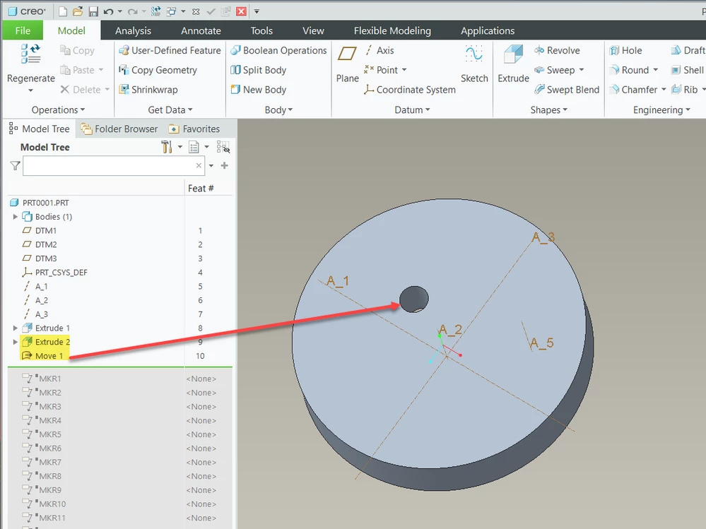

After removing or moving circular cuts by using commands under flexible modeling tabs, axes of cuts remain at their old place. I know you can move surfaces with their respective axes, but I need a way to delete them rather than moving. It is not the case when you use remove as well. I tried to find those axes from layer tree but did not work either. You can create new axes where you move the old cuts/holes, yet I need the erase old ones.

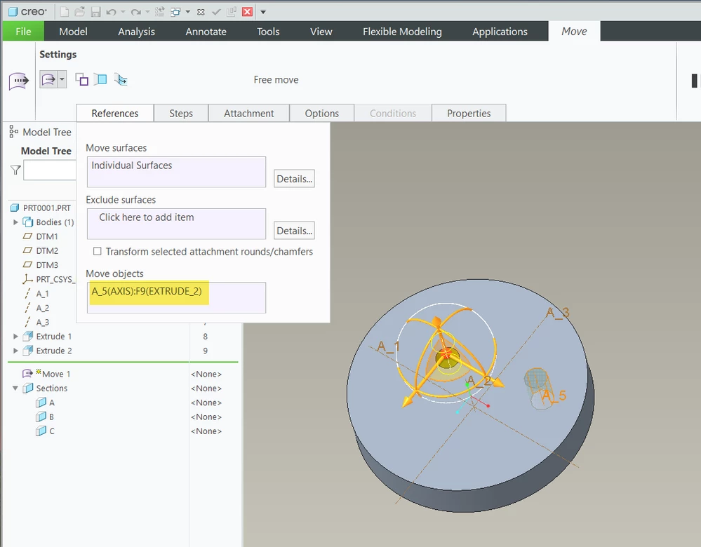

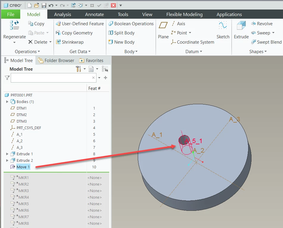

If I am understanding your request correctly, you can hide the axes using layers, but you will not be able to delete them from the model without deleting the feature that is their parent. You do have the option of moving the axis using the flexible move function (see last pic below), this will effectively hide the axes you want to delete when the flexible modeling move is regenerated,
You are not able to remove the axis in this scenario due to the existence of a feature that is a parent to the Flexible move or remove operation that is still part of the history of the model. There is a hybrid modeling paradigm when using flexible features such that the parametric feature history is preserved. This can be seen in the pictures below where the axis is persistent. A flexible move is used to shift the location of the circular cut but the axis of extrude 2 remains in the location where the extrude was defined.
You can resolve this by using the move objects selection in the flexible move command.

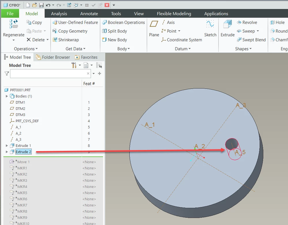

tbraxton
Mar 18, 2025 11:51 AM UTC
This would lead me to ask the question of why you are not deleting the hole or circular cut features? This obviously will get rid of the hole and axis.

Dale_Rosema
Mar 18, 2025 12:06 PM UTC
They are part of the history (recipe of the cad). A hole was created in a spot. Then the hole was move x, y, z. Without the first spot, the software has no reference for x, y, z. So you either have to hide the axis, move it, or delete the hole that is referencing it.
