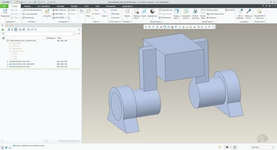

Rotating component with bearing housings:

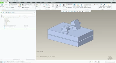

Top assembly with baseplate:

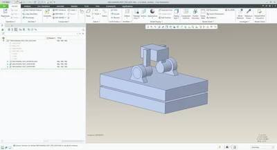

What I am able to do with a Family Table and Angle Offset of the rotating component:

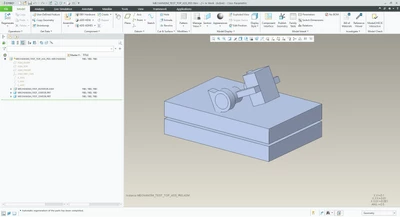

What I would like to see when I open the Family Table "rotated" instance, preferably without needing to also set an Explode State:
