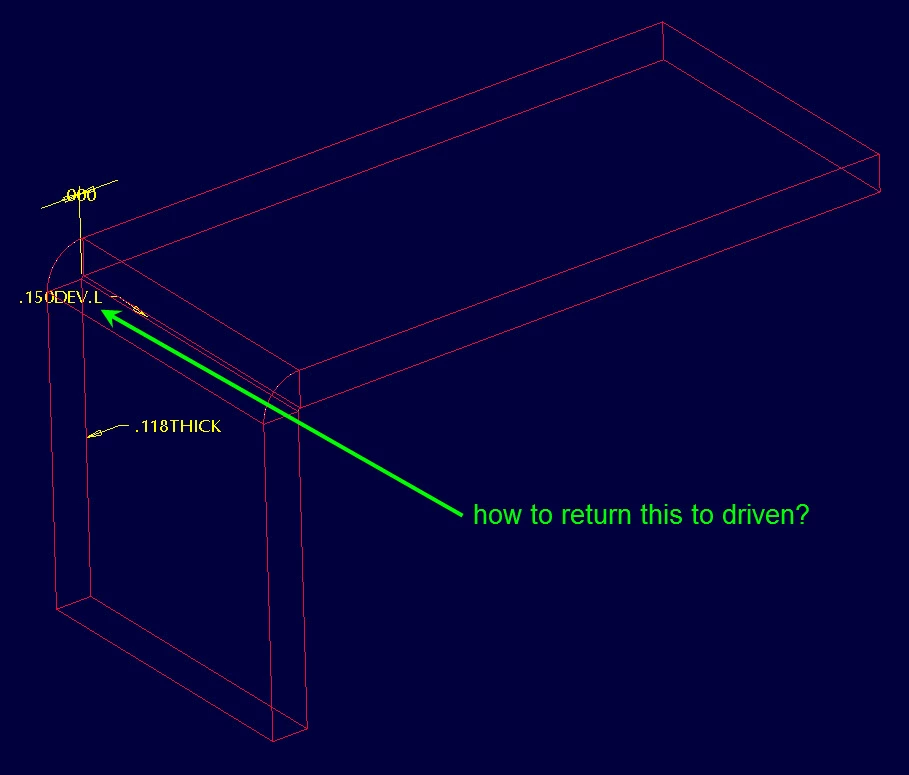

If I make a sheet metal wall with a flange wall or flat wall feature, I can override the bend's default developed length by going >Edit>"DEV.L".
If I want to change it back I can go >Edit>"DEV.L"> "Return to Driven" which sets the developed length back to the value set by the k_factor.
Trouble is, some of our people create the same geometry with a simple extruded surface (or copied geometry from a non sheet metal part) and then create the wall with the "Offset Wall" command. When they do this, it is also possible to override the developed length to be a specific value. BUT, it is not possible to return it to driven.
Does anyone know if there is a way to do this? I suspect not, but thought it would be worth a shot. Please don't ask why we are doing it this way... we have our reasons.
