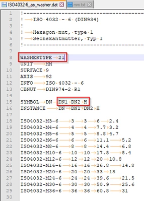

  1. Copy the file ISO4032-6.dat and rename it to ISO4032-6_as_washer.dat.
  2. Open the file and change NUTTYPE 1 to WASHERTYPE 21

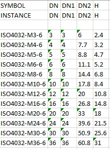

  3. Change the  columns in the file like shown in the image
  4. Finally the file should look like this
    2020-02-13_15_49_38-C__Users_oli_Documents_buw_IFX_parts_ifx_6_ifx_fastener_data_ISO4032-6_as_washer.png

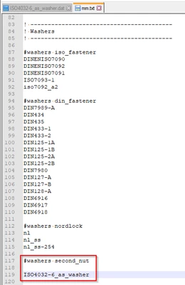

  6. Now add this new nut to your catalog. I have added it to the mm catalog to a new group 'second_nut'. If you want you can add a icon for this new group. Simply copy the attached 'second_nut_icon.png' to the 'ifx_catalog' folder in your IFX installation.
