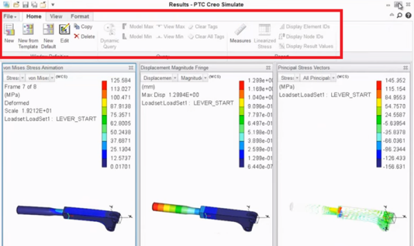

Ribbon bar menus
The logically organized interface with commonly used tasks, sorted into application-specific ribbon bar tabs and groups, makes it easy to use, and for new users, easier to learn.
It is easy to find the actions you want to perform since tasks are sorted into application-specific ribbon tabs and groups, as shown in the red box.
