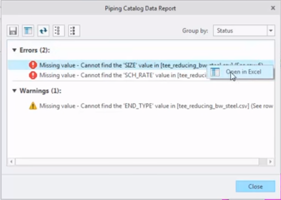

With specification-driven piping, Creo 4.0 now has a tool to validate the piping data catalog files.

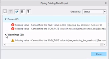

Results grouped by status in the results dialog.
Any errors found in the validation results must be resolved before you can use the piping data catalog.

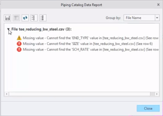

You can group the errors and warnings by status, file type, or file name. In this example, you can see that all the errors and warnings occur in the same file.
The errors in this report are found in the tee_reducing_bw_steel.csv file.
Selecting an error line, right click, and select Open Excel, and the report results open the file that has the issue. You can then edit the file to resolve problems.

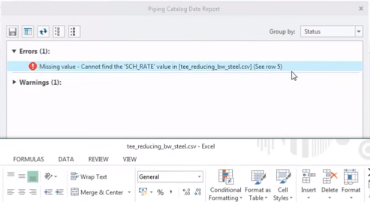

Opening the file in Excel.
When you save the file and re-run the results, the report tool will check the files again. In the example below, we can see that we now have one error and one warning.
Also note that the report shows you the line where the error occurs.
Here you can see that the error occurs in line five.

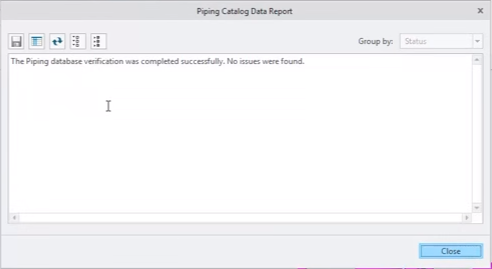

Once you have resolved all the errors in the Excel file, simply save and refresh the results in Creo to check that you have resolved all the issues and that the catalog is now up to spec.
All errors and warnings have been corrected, so the report is empty.
